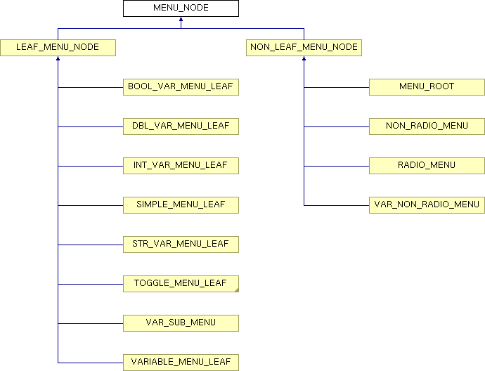

Inheritance diagram for MENU_NODE:
LEAF_MENU_NODE NON_LEAF_MENU_NODE BOOL_VAR_MENU_LEAF DBL_VAR_MENU_LEAF INT_VAR_MENU_LEAF SIMPLE_MENU_LEAF STR_VAR_MENU_LEAF TOGGLE_MENU_LEAF VAR_SUB_MENU VARIABLE_MENU_LEAF MENU_ROOT NON_RADIO_MENU RADIO_MENU VAR_NON_RADIO_MENU List of all members.
